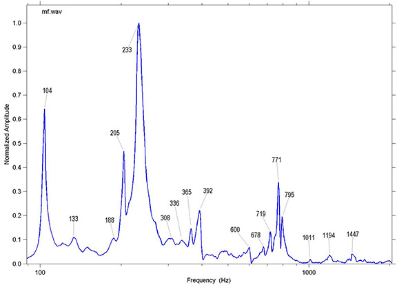

Suppose you input a perfect white noise signal (some sharply peaked short duration sound like tapping) into a guitar and then measured a frequency response with some electronics (BTW I haven’t done this but I’m betting you have). Presumably, you would have some band-limited response over some range that falls off at the ends at so many db/octave and some characteristic peaks and valleys throughout the spectrum that result from geometry, material makeup of the guitar, etc. etc..
Marc, to satisfy your curiosity, here is the kind of response you get with a tap as you describe. I don't recall the exact state of the guitar (it may not have had the bridge yet), but overall it shows the kind of thing you see.

Thanks, Pete: I haven't figured out yet how to post pics on this forum.
The peak in Pete's chart at 104 Hz is usually called the 'main air' peak, and the pair at 205 and 233 are called the 'main top' and 'main back' peaks. This is not strictly a true way to talk about them: acutally, the activity of all of these things is coupled together, and what you're seeing in the chart is a sort of sum of all of them. The actual resonant peaks for the seperate parts (if you could seperate them) would not be at those pitches.
If the box were a really simple shape, and the 'main air' and 'main top' resonant modes were all that was happening, the curve would just fall off above the 'main top' peak in some simple way, like 6dB/octave. The spectrum of every note above that main top pitch would be the same, if you played the string the same way, and the timbre would be boring.
This is the basic design of a 'bass reflex' speaker cabinet. They use speakers that have as broad a frequency output as possible to begin with, and then put them into a cabinet that is tuned to have it's 'air' response at the same pitch. The cabinet is lined with foam or other damping material, to make that peak as broad as possible, too. The result is that the two peaks you see in Pete's chart become more of a low, broad, hill with two minor 'humps', and the response falls off very slowly above that. Again, the price for this is inefficiency: broad response speakers have high damping, by definition, and the damping in the box also dissipates energy. The 'flat' response requires a lot of power to drive to usable levels.
The problem, as near as I can figure it, is that most of the higher resonant modes that provide the 'interesting' features in that chart are 'losers': they tend to subtract power from the output, rather than adding it. This seems to be most true in the range between about 400-1500 Hz, I think. So you need that stuff for 'color', but you don't want too much or you lose power. One of the little conundrums of lutherie.

Thanks Pete the sound spectra helps my understanding a lot.
PostPosted: Sat Dec 09, 2006 12:59 am
Posts: 606
Alan thanks for the explanation, the graph Pete posted makes things much clearer. If I understand, the lower peak is created by air, a sort of 'blowing over the top of a bottle' effect and the vibration of the top and back together is coupled with this peak--a squeezing effect.
This low peak is hovering around the low-E string, in fact on this particular graph it is on a G#, so I would expect an unusually strong G# on this guitar. I would also expect that if I could remove the top and back and futz around with the tuning (brace shaving etc.) I could change the shape and strength of this peak, right? I would also expect a strong A# just below the B open 2nd string, and also relatively strong open B string, a weaker open first string then a resonance on G (392)where there is a small peak just below A 440. Would that be correct?
Another question, are the 392 and 771 peaks related to box geometry? The wavelength (in air) for the 771 peak is around the inside dimensions of the box 17 to 18 inches.

Marc wrote:
"If I understand, the lower peak is created by air, a sort of 'blowing over the top of a bottle' effect and the vibration of the top and back together is coupled with this peak--a squeezing effect. "
Again, the lower peaks in the chart are the result of the way the top, back, and air work together on that guitar. A rigid guitar-shaped box would most likely have an 'air' peak at around 125 Hz, and a 'backless' box would probably have a 'top' peak around 180. The coupling moves them apart in pitch. It would not surprise me at all of the 'main back' resonance on that guitar was actually near 210 Hz, in the 'dip' on the chart, but it also contributes to the height of the 'air' peak.
"This low peak is hovering around the low-E string, in fact on this particular graph it is on a G#, so I would expect an unusually strong G# on this guitar."
Possibly; but I don't remember it being all that strong. Hearing is logarythmic, and that really smooths things out.
"I would also expect that if I could remove the top and back and futz around with the tuning (brace shaving etc.) I could change the shape and strength of this peak, right?"
You'd get a lot more change from altering the soundhole size. We _do_ call this the 'main air' peak, and that's because most of the energy is tied up in air motion. You'd have to make some pretty big changes in the top to alter the pitch a lot.
"I would also expect a strong A# just below the B open 2nd string, and also relatively strong open B string, a weaker open first string then a resonance on G (392)where there is a small peak just below A 440. Would that be correct?"
Again, the differences are not all that pronounced in real life. For one thing, any note you play on a string has a whole raft of higher partials, and each of those is also coupling more or less strongly with the air in the room through the higher resonances of the box. What you percieve is the sum of all of that, weighted strongly toward the high frequency stuff. It's quite possible for a note with a fundamental that falls right in a 'dip' in the low-range spectrum to sound very loud, simply because it has a couple of higher partials that drive well. The timbre changes, of course, but that just makes it 'interesting' if the change is not too pronounced. The phenomena the OP was talking about may well have had to do with just such a too-great change between adjacent notes or stretches of notes.
"Another question, are the 392 and 771 peaks related to box geometry? The wavelength (in air) for the 771 peak is around the inside dimensions of the box 17 to 18 inches."
Possibly, but it's not that simple. The 'A-1' air mode on most guitars, which is the lowest lengthwise 'pipe' resonance, is usually around 350 Hz. It is set by the box length, mostly, but the box is rounded off, and the walls are somewhat compliant, and those effect the pitch. It also generally couples with the top 'long dipole' mode, which is often near the same pitch, so you tend to get two peaks, in the same way that the 'main top' and 'main air' pitches couple. On top of THAT, there seems to be some influence both from the waist and the soundhole location. The upshot is that I would not be at all surprised to find that the two peaks at 365 and 392 were due to that top-air couple, or even to find that one part of that couple produced a dip, say the one near 350, or the low peak at around 425.
As you get much higher than that in pitch it becomes more and more difficult to assign any peak or dip in the output to any one or two resonances. Resonances start to come in so close together up around 600-700 Hz or so that we tend to talk about a 'resonance continuum'. It's possible to move a particular peak in that range, if you want to, but difficult, at best, to predict in advance what those peaks will be, or what the result will be someplace else if you move one.
The good news is that, in some sense, it doesn't matter as much just where the peaks and dips are up there, so long as you've got them. Those high-end peaks seem to translate into 'tone color'; too few and it sounds 'uneven' too many and it can sound 'flat', too peaky and it can sound 'harsh', too flat and it can sound 'dull'. Other than not wanting them all bunched up in one place, that's about it, as far as I can tell. A different distribution will probably sound 'different', but may not sound any 'better' just so it meets the other criteria. Pete's guitar, BTW, seems to fill the bill.
